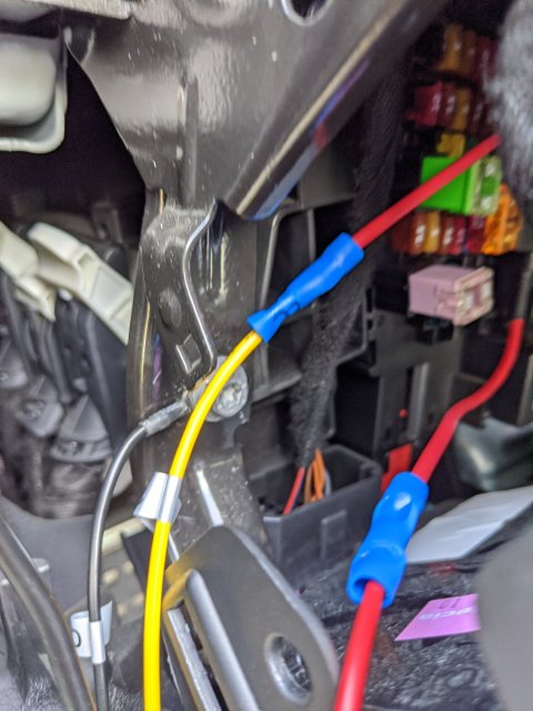

Wondering if I can get some help. I just got a Viofo A129 Pro Duo and am hardwiring it to my 2017 S3. I followed the recommendations here to use F38 for constant and F48 for ACC power as they were both unused fuse positions on my S3. However, when I test my dash cam, there is no power. Not sure what is causing the issues if these Fuse positions are constant and ACC as stated. Any help is appreciated. IMG_20200523_160759.jpg IMG_20200523_160752.jpg

Sorry to resurrect, I'm just doing this job for a Nextbase 622GW dashcam, using their hardwire kit.
Having read through the thread start to finish I felt it would be useful to point out one perhaps important addition. When there is a fuse location in the fuse box that is empty 'due to the exact optioned version of your own car', there is often no leg connector in the back of the box for where 'one' of the two fuse legs would slot in. This is why when some here have discussed using a previously unused slot (rather than taking a used slot fuse out and using the piggy back type connectors supplied with many dashcam hardwire kits) they seem to get no power at all, under any ignition key position circumstance.
The options then are to a) use a fuse location where there is already a fuse in place and to support this you would use a piggy back type fuse adaptor that comes with many of the dashcam hardwire kits, or from an auto accessory store, or b) if using a fuse location that has previously always been empty, make sure that you can see shiny metal to indicate there are connectors for where 'both' of the fuse legs will slot in.
Hope that makes some kind of sense.
